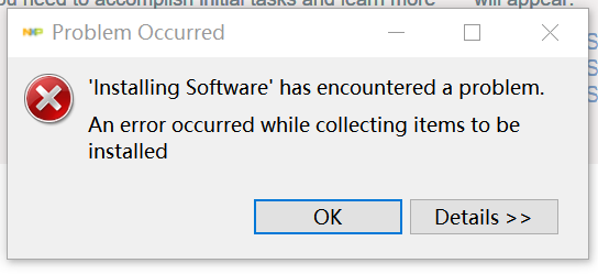

when I installed new software in S32DS 2018, I failed several times.
this picture shows the problem I met
what's wrong with that?
how to solve the probiem?

Hi Victor,
I'd recommend you to install the latest release of S32DS for ARM  (v2.2) instead:
S32 Design Studio for ARM 2.2 (Windows/Linux) released!
If you need to stay with an older version 2018.R1 please try to use online method for update installation
Please check the update announcement (link below)  and follow the installation instructions:
S32 Design Studio for ARM 2018.R1 - Update 11 available
Hope it helps.
