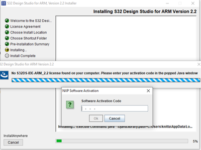

I am trying to install S32 Design Studio for ARM version 2.2 on Windows 10 and after entering the activation code it says that it is rolling back the installation and then exits.
I have tried the solutions posted here (delete TMP environment variable) and here  (delete 'C:\ProgramData\FLEXNet') with no success.
I do have administrator privileges on the PC in question.  The installation log is attached.
If anyone can advise what I need to do to install I would greatly appreciate it.

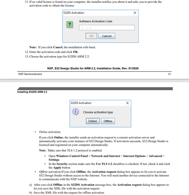

@mikedoidge  thanks for the reply.  The instructions on the page you linked are for the 2018 version.  I'm not seeing an offline activation method choice when trying to install version 2.2 (see screenshot below).  Is there a different way to do offline activation with 2.2?
Andy

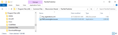

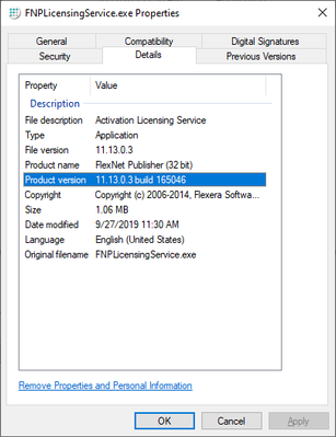

One more item, could you please check the details on the following file:
"C:\Program Files (x86)\Common Files\Macrovision Shared\FlexNet Publisher\FNPLicensingService.exe"
We are interested to know the version, in case it is different:
Mike
5,348 Views
andyknitt
5,314 Views
mikedoidge
Hi @andyknitt,
We reviewed the files you sent and the image of the version of FNPLicensingService.exe. We noticed that the version of FNPLicensingService.exe is newer than the one supplied by S32 Design Studio installer. Though this may appear to be a small difference in version, it could easily cause the issue. Also, we think it is consistent with the error details in the log files you sent.
Here is our proposal:
Rename the file FNPLicensingService.exe, then again try the install of S32 Design Studio. The version of FNPLicensingService.exe supplied by the S32 Design Studio installer will then be placed in the folder next to the one you renamed. This will hopefully resolve the issue and you will be able to complete the installation.
If this solves the issue, we may consider updating to a newer version of the FNPLicensingService.exe in a future release.
Mike

The option to select between Online and Offline activation type is presented after you enter the Software Activation Code.
These steps are also covered in the 'S32DS_ARM_Installation_Guide.pdf', which is available on the Flexera site when you download the installer file.
Mike
5,421 Views
andyknitt
@mikedoidge as soon as I enter the activation code and click "OK" it says it's rolling back.  I never get to the point where it asks about online via offline activation. Anything else I can try?
Andy
