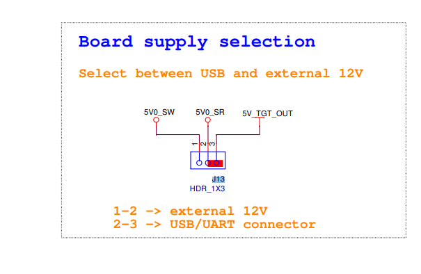

Also please check reset LED. If it is ON then probably a reset escalation has occurred (a code inside causes MCU reset - 10x reset = reset escallation).
The debugger might have difficulty to connect to MCU if it is in reset escalation mode.
Therefore sometimes it helps if you power-up the board immediately after pressing debug button so the debugger initiates connection before reset escalation occurs.
You can use jumper J13 on MPC5744P Devkit board for this purpose :
1) Simply remove jumper - MCU is not powered
2) press Debug button and put the jumper back at its original position
3) after few attempts the debug connection should be established

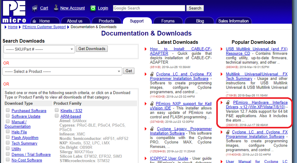

As a general suggestion I'd recommend re-installing up-to-date Pemicro Drivers:
and updating S32DS for Power:
