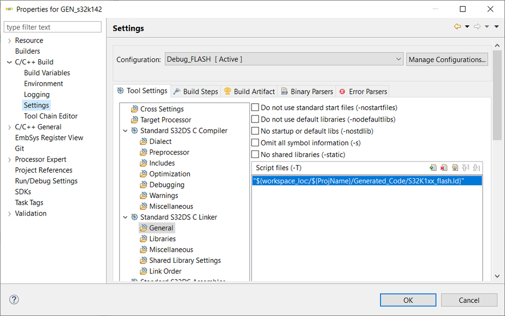

jiri_kral
you can specify linker path in linker general options:
I tried to reproduce the issue, but no success. Is path to linker script specified in settings in your project?

tibor_bekesi
Hi Jiri,
Thanks for your support and sorry for my late reply.
Yes, path to linker script file is specified as follows:

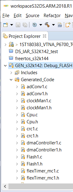

And here you are my Processor Expert options as well:
However I do NOT see S32K142_32_flash.ld linked resource under my Generated_Code folder:
Even if I modify the path to the linker script file, the -T option still remains empty double quotes (-T "").
Tibor

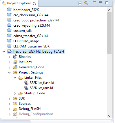

Hi Tibor,
normally is linker script located in Project_settings folder:
Are you started your project from scratch or did you reuse some example project?
Jiri

tibor_bekesi
Hi Jiri,
Yes, I know that in the example projects usually the linker scripts are located under Project_Settings folder.
However, in my case it should reside in Generated_Code folder if I understand correctly the Processor Expert configuration of my project (see screenshot in my previous comment).
In fact S32K1xx_flash.ld is missing under Generated_Code folder.
The project that I am working on (GEN_s32k142) was created earlier by one of my colleagues, I only took it over and checked it out from a Git repository.
