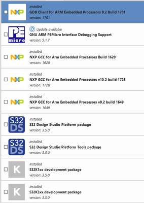

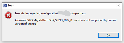

I get the following error while trying to open the pins wizard:
I have S32 Design Studio for S32 Platform, Version: 3.5 installed together with the following extensions:
I have seen similar errors regarding S32K1 and theirs solution suggested to download SDK and install it offline, but I can't seem to find the S32K3_2022_03 SDK on S32DS website. Can you please provide us with help so we can open this project?

Hello @matej_15,
Please login to your account and proceed all the way until you reach the Product List page. Then try this link: https://nxp.flexnetoperations.com/control/frse/download?agree=Accept&element=13397517
Download the file: SW32K3_RTD_4.4_2.0.0_DS_updatesite_D2204.zip  this matches the version shown in the error message.
I see from the release notes that S32 Design Studio v3.4 Update 3 is supported. So you may need to have S32DS 3.4 installed with Update 3 and no later updates. If you have already installed Update 4 or it forces you to install Update 4, you can try it, but if you still get an error, then try with a fresh install of v3.4 and Update 3. You may need to download the Update 3 and disable the S32DS online update site to prevent it from seeing Update 4.

AbhishekK
I have used this S32DS 3.4 update 3 and  RTD package as mentioned . but still facing the error .
I am try to build this Examples
