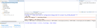

USING S32DS 2018.R1
When I build the project ,there is a problem.
Cannot run program "": Launching failed
Error: Program "" not found in PATH
PATH=[C:/NXP/S32DS_ARM_v2018.R1/eclipse/jre/bin/client;C:/NXP/S32DS_ARM_v2018.R1/eclipse/jre/bin;C:/NXP/S32DS_ARM_v2018.R1/eclipse/jre/lib/i386;C:\Program Files (x86)\Vector vFlash 3.1\Bin\;C:\ProgramData\Oracle\Java\javapath;C:\Windows\system32;C:\Windows;C:\Windows\System32\Wbem;C:\Windows\System32\WindowsPowerShell\v1.0\;C:\Windows\System32\OpenSSH\;C:\Program Files (x86)\WebEx\Productivity Tools;C:\Users\hzh1admin\AppData\Local\Microsoft\WindowsApps;\bin;C:\Program Files\Git\cmd;C:\Users\uidq2224\AppData\Local\Microsoft\WindowsApps;;C:\NXP\S32DS_ARM_v2018.R1\eclipse;]
Why is this a problem and how can I solve it ?thanks

please make sure that you are running debug probe based session (PE Micro, Segger j-link...):
Your issue is mostly caused by running C/C++ Application debug session.
Jiri

Hello Facing same issue .
can you please eleabrate little bit ,what you want say ?
what changes need to do ?
