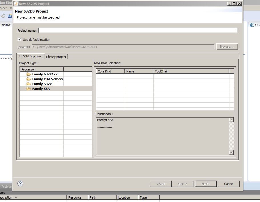

yunus_ozdemir
I am newbie on S32DS. I am trying to create a new project like File -> New -> New S32DS Project. I couldn't see processors. Something installed wrong way or not installed yet? Waiting for your help.
Thanks in advance

stanish
Yunus,
Specifically for KEA there are multiple choices. It's supported by both CodeWarrior for MCUs 10.6 and KDS There is also a standalone flasher available for programming by pemicro:
P&E Microcomputer Systems: Over 30 years as an Industry leader in Embedded Systems Development Tools...
Stan

vinithabm
Hello Yunus,
I got to know the solution.
I need to install S32 Design Studio for Power Architecture IDE, (not S32 Design Studio ARM) that supports MPC5748G controller.
Power Architecture IDE, they are releasing within a week.

stanish
Hello Yunus,
Thanks for the update.
Regarding system requirements - it's mentioned in the release notes (c:\Freescale\S32_ARM_v1.2\S32DS\Release_Notes\Release_Notes.pdf). See the snippet below.
Anyway in your case I suspect the issue might be caused by an interference with another application/program.
I've informed our development team about the issue so the investigation is in progress.

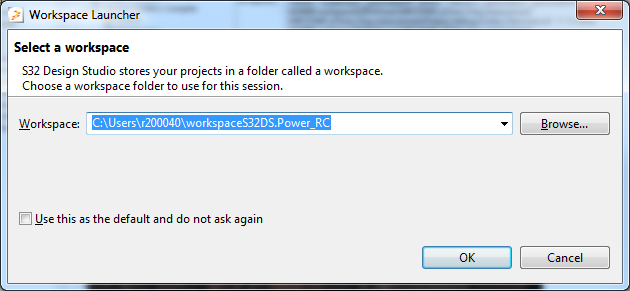

stanish
When you start S32DS IDE it asks you to enter a workspace directory:
So if you add a new folder which doesn't exist yet it creates a blank new workspace for you.
S.

stanish
One more comment:
Could you try to use a new clean workspace?
S.
