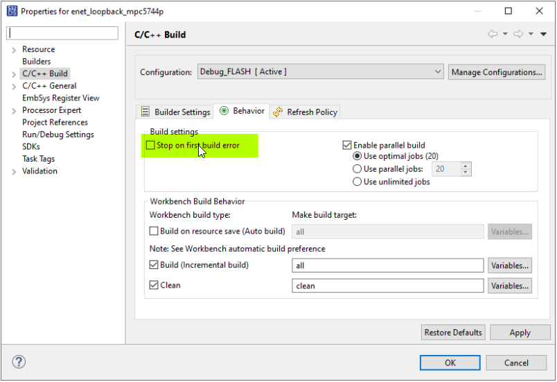

Hi:
      I ran into problems compiling the MPC5744P project using S32DS.Power.2.1,properties→C/C++ Build→Builder Settings→Build command only use make,not make -k. When I compiled MPC5744P, I could generate elf files, and when I generated s19, missing separating.stop appeared.
     Why can't I manually change Build command from make to make -k.
     Looking forward to your reply. Thanks.

I'll put the answer here as well (I sent you email from ticket system):
you can set the make command in project properties:
Make sure, that the -k is not overridden by stop on first build error in behavior tab:
2,011 Views
jiri_kral

shizhuangfei
Thank you very much for your timely reply.
My problem has been solved.
It's due to an encryption problem on my computer.
