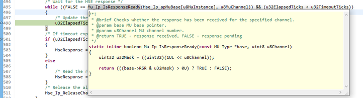

Create a project from the example Crypto_Symmetric_Primitives
running the configuration tool
attacking the SDK as required to the modules
building the project and running it step by step looks like it stuck in the following line in Hse_Ip.c
looks like it is waiting for Hse response
but the response is FALSE

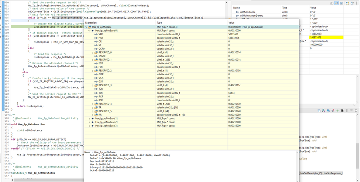

the Hse_Ip_apMuBase is like this
What am I missing ?

Have you installed HSE FW prior to running this example? Since Crypto drivers make usage of HSE FW, there is a need of the HSE FW.

For RTD v4.0.1 we are not seeing any compatible HSE FW. The latest version (v1.0.9) has support under the RTD v4.0.0 P03.
Also, the silicon revision is important. If you are using the rev2.1, HSE FW v1.0.5 is not compatible, you need to move to the newer one and select the binary for rev 2.1.
