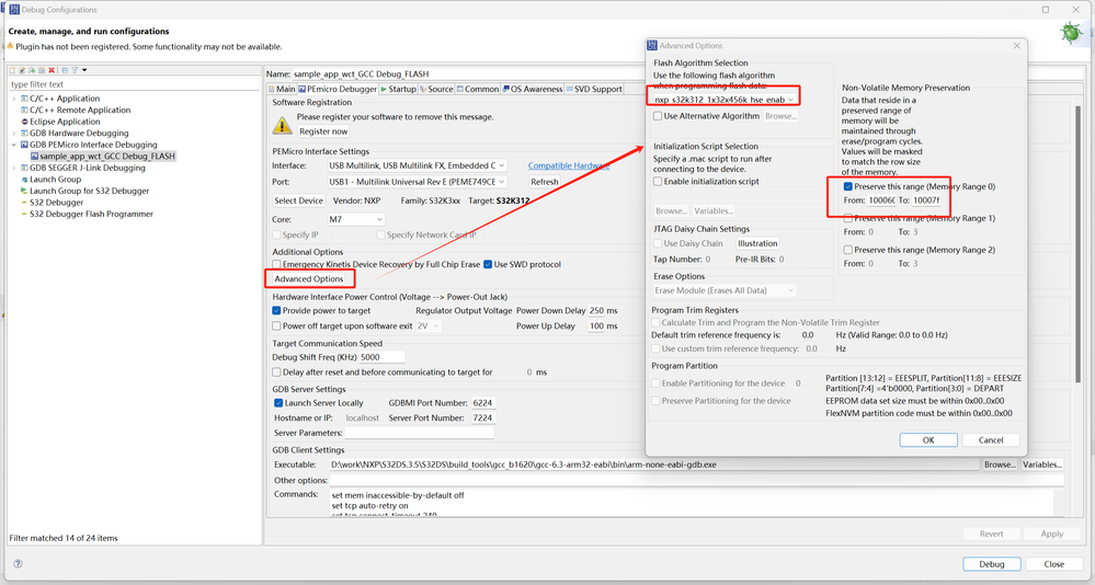

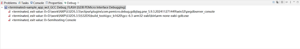

When I used PE to debug burning, I encountered an error message from p&e semihosting console. See Figure 1 and information for details. Hope to get your help! Thank you very much for your advice!

Command Line :D:\work\NXP\S32DS.3.5\eclipse\plugins\com.pemicro.debug.gdbjtag.pne_5.9.3.202411271449\win32\pegdbserver_console -device=NXP_S32K3xx_S32K312 -startserver -singlesession -serverport=7224 -gdbmiport=6224 -interface=USBMULTILINK -speed=5000 -p

CMD>CM D:\work\NXP\S32DS.3.5\eclipse\plugins\com.pemicro.debug.gdbjtag.pne_5.9.3.202411271449\supportFiles_ARM\NXP\S32K3xx\nxp_s32k312_1x32x456k_hse_enabled.arp

;begin_cs device=$00400000, length=$001D4000, ram=$20400000
Loading programming algorithm ...
Error enabling module, part timed out during buffer initialization.
Error loading programming algorithm - load aborted.
Error occured during Flash programming.

PEmicro GDB Launch Failure : Error during flash programming. Terminating debug session.
PE-ERROR: Error downloading to the device. Terminating debug session.

Hi @alan1204,
Does this happen with an example from the SDK/RTD or an empty project? Also, why are you preserving those memory ranges? That is usually for applications such as bootloaders (Preserving Memory Ranges with Eclipse and P&E GDB Server).
If you can, please share your project to test it on my side.
Julián

Thank you for your reply, this range is provided by the customer, the customer on their prototype burning normal, we change a computer burning will appear as the above error. Is this related to the version of PE?

Hi @alan1204,
It could be related to the PE Micro's drivers. You can try to update them through Extensions & Updates.
But firstly, I'd recommend creating a new dummy single core project for the S32K312, build the project and debug via PE. If you are able to debug - the issue is related to your custom project or board.
Julián
