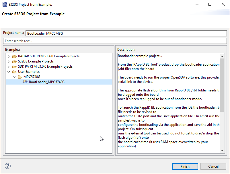

I'm not sure about your scenario. Ideal configuration is to have two independent projects - Bootloader and Application project. Application project has shifted .text area address from boodloader.
Anyway - in S32DS for Power v 2.1 is Bootloader example. It is for MPC5748G - but you can look at it just for reference: pastedImage_1.png
