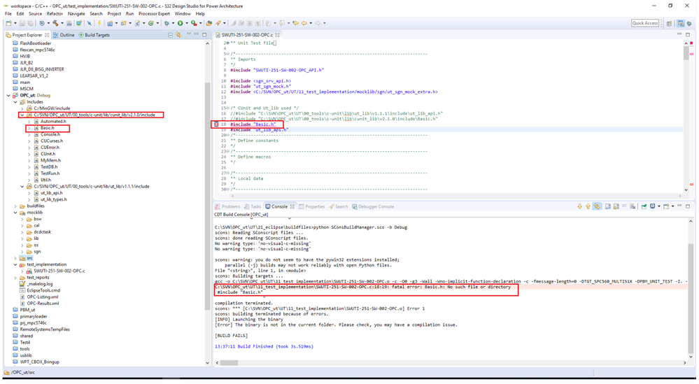

The path is there, the file is there. Still I get a "fatal error: No such file or directory".
Do you see anything or know anything that I am doing wrong?  TIA.
In this figure, you can see the include directories and the file being included and the error.

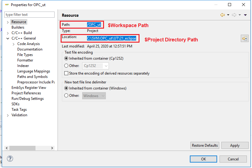

In this figure, you can see the Project Path and the Workspace Path. (I was wondering what ${ProjDirPath} was)

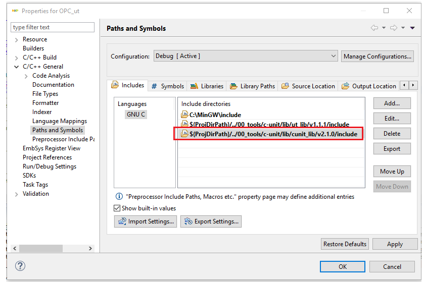

In this figure, you can see the path to search for includes.

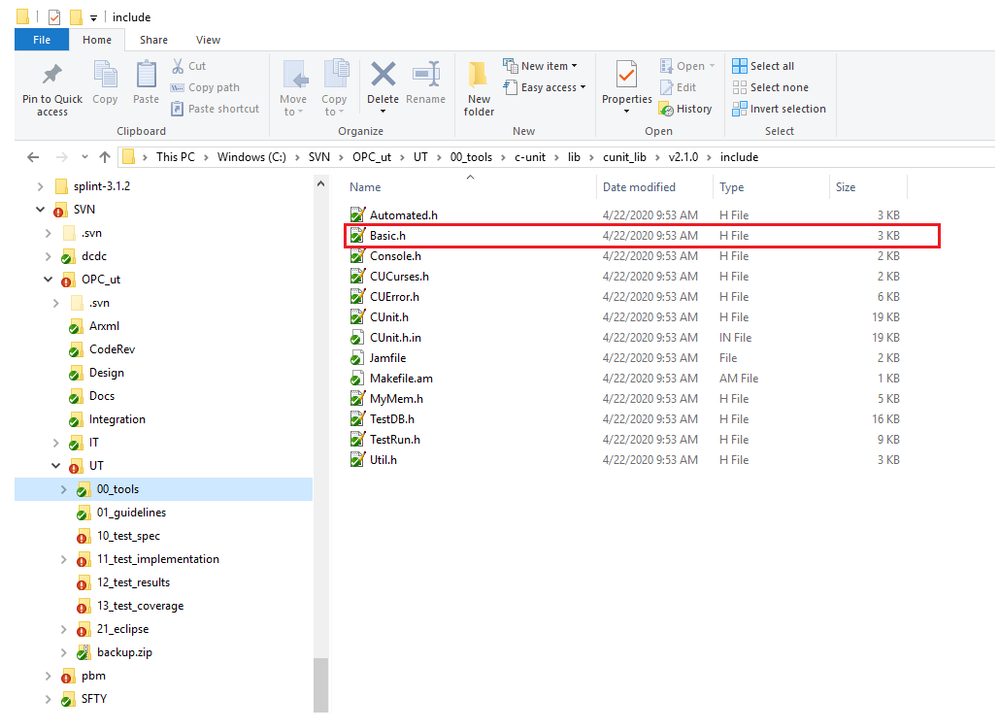

In this figure, you can see the file and path that I am trying to include

can you please share .args file? It is located in folder where is your build target (and makefile). It looks, that the include path is not properly expanded.

My mistake.
There is no .args file.
The project is being built using SCONS.
There must be some kind of path setting in the .scons somewhere.
I thought it was a problem with S32.
Well, at least I know what to look for now.
