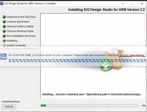

S32DS_ARM_Win32_v2.2 Install Anywhere error
I failed installs of the S32DS_ARM_Win32_v2.2, on  my PC.
The window asking for activation code is not opening in his case, the installation is just falling back and uninstalling itself.
I run the installer using admin rights.
Attached is the last installation log failure: - it doesn't say much about the cause:

james4
In the process of installing,show in the picture,the popup window of activation code couldn't popup and rolled back.What is the problem?

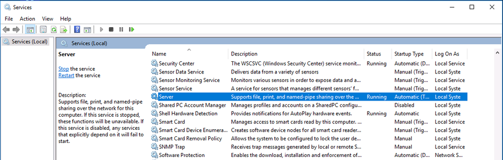

mikedoidge
Hello [email protected]‌,
1) You indicated that you run the installer using admin rights. The installation should be conducted from a user account that is part of the administrative rights group, this does NOT mean to execute the installer using the option 'Run As Administrator'. Please confirm that you are meeting this requirement apropriately.
2) If the above admin rights are confirmed, then please check the document: https://community.nxp.com/docs/DOC-345238 The solution here may work for your issue.
Please reply back with your response on the 2 suggestions above.
Mike

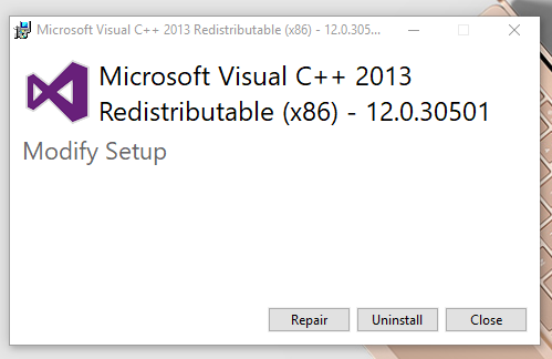

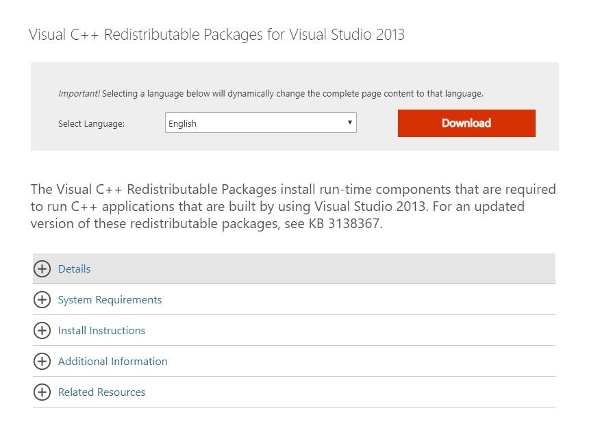

After further analysis, your issue is cause by missing Microsoft Visual C++ and 2013 Redistributables from Microsoft website. This is supposed to be installed when S32 Design Studio is installed, but it seems it must be failing for some reason. Perhaps you could try to install directly from Microsoft and see if it installs, or if it fails perhaps you can see the reason.
Please try this and let us know if you are successful in completing the S32 Design Studio installation.
Mike
28,266 Views
james4
I download the Microsoft Visual C++ 2013 Redistributalbe from Microsoft websit. When installing it,it indicated I had installed it.
Then reinstall s32ds,the error is the same.
28,266 Views
mikedoidge
Please check that both 32- and 64-bit redistributables packages are installed. When you get the prompt, please use the 'Repair' button to reinstall.
Mike
28,266 Views
james4
The two vision packages are installed. The error is the same.  I decided use  IAR as  my ide.

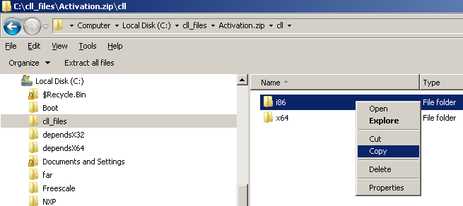

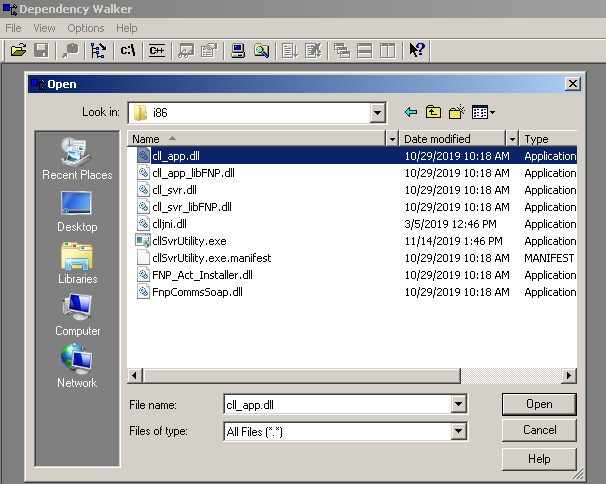

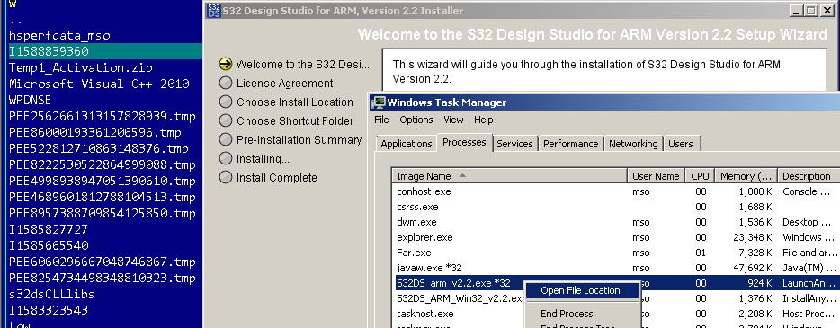

The new log appears to be same as previous, so no new details are to be learned from it.
I can assure you that this is not a usual type of problem. Most of the few problems encountered by our users are solved by the steps I shared with you earlier.
Before installing S32 Design Studio, was your PC a fresh installation of the Windows OS? It is possible that some services are missing which we would normally expect to already be installed.
Our experts have suggested that it might be necessary to perform an investigation using the tool 'dependency walker'. Please see the following steps:

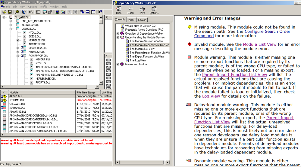

Deeper steps could require Dependency Walker https://en.wikipedia.org/wiki/Dependency_Walker
You can suggest to investigate the problematic DLL with 32-bit DW:
Although, obtaining that DLL could be tricky, e.g.:
Best Regards and Stay Safe,
Mike
