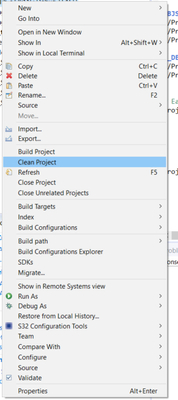

    • When I compile the demo project, the following error occurs.
      • How can I fix this error

Hi @Lv_Jm
did you click on Update Code icon in the configuration tool?
This is copied from the example description from user manual:
The button can be found here:
Lukas
2,533件の閲覧回数
Lv_Jm
I HAVE done that but it still have errors when compiling
2,497件の閲覧回数
mikedoidge
This error doesn't appear to be the true source of the issue. The incremental build is complaining the object files are not found. Try performing a 'Clean Project' first, then a full build and share the errors that result.

Lv_Jm
thanks,A few days ago, I formatted my laptop and reinstalled S32. The problem has been resolved, but thank you all the same.
