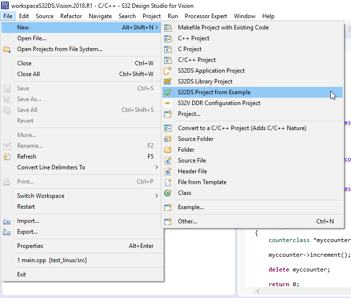

This example is already part of S32DS installation - you don't need to import it. Click on File -> New->S32DS Project from Example

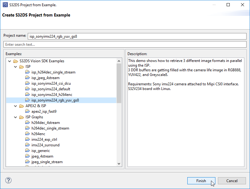

and choose example you are interested in:

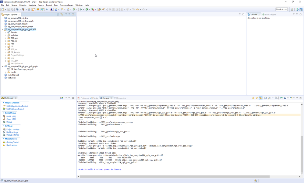

You should be able build it without any issue:
Hope it helps.
