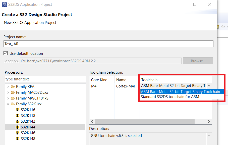

I installed IAREW plugin manager in S32DS for ARM 2.2, but there is no IAR toolchain for S32K1xx.

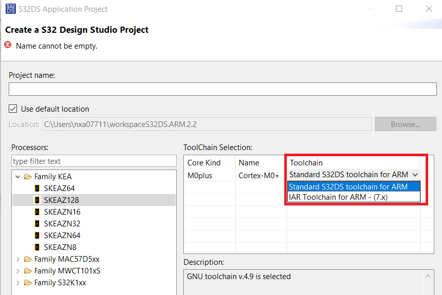

However, IAR toolchain can be selected for KEA as below.

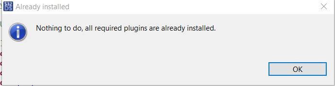

I tried to install it again, but it was same.

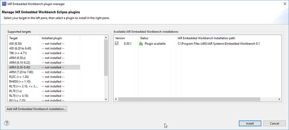

I just tried it and it works for me. But I installed IAR plugin v8.xx (v7.xx is not available on my machine):

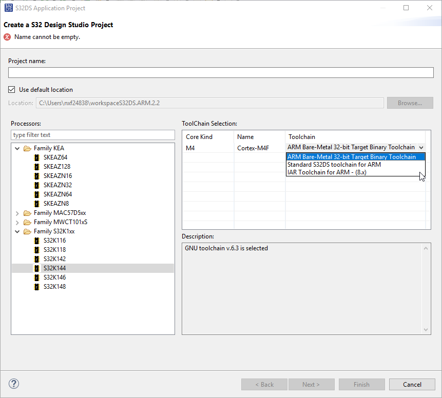

After installation I can choose IAR toolchain:
So, try to Install v8.xx - hope it solves your issue.
