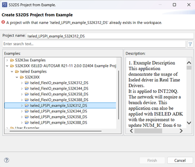

Hello.
I created ISELED example.
When I load this project, S32DS popup error message.
How can I load this project ?
S32DS v3.5

Hi @ssean
The example you shared is the most recent one, so the best option is to create a new project with the right RTD version. Then, just copy the application source files from the pre-existing project, along with any customizations of the project properties.
Sorry for the inconvenience.

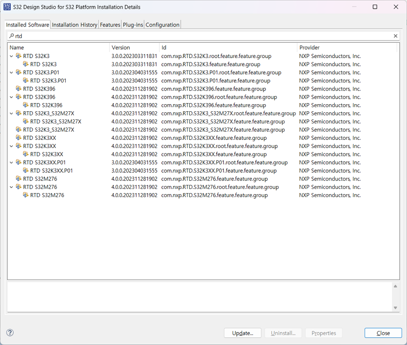

VaneB
Hi @ssean
Could you please verify that you have correctly installed S32K3 RTD 4.0.0? This version is required for S32K3 ISELED R21-11 2.0.0.

ssean
Hello @VaneB
Here is my installed RTD list.
I have RTD 3.0 and 4.0.

VaneB
Hi @ssean
According to the information provided about the installed packages, it seems that you have several RTD versions installed in your S32DS instance. To rule out a possible cause related to a package conflict, could you please uninstall all the packages and only reinstall the RTD version 4.0.0?

ssean
Hi @VaneB
After deleting all RTDs and reinstalling version 4.0, the ISELED project can be loaded.
