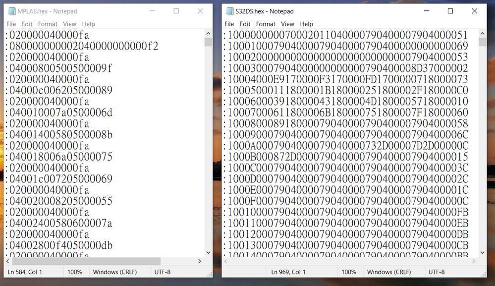

Hi, everyone
I am trying to learn to understand HEX file.
The ultimate goal is the production of bootloader.
But I encountered two problems while reading HEX File.
1. microchip .hex VS S32DS.hex:
I use Notepad to open the MPLAB.hex, there will be a lot of
:020000040000fa
:04027c005806000020
Two messages,
But why S32DS.hex does not.
Is it because of some functions written in the program?
Are they necessary? Or I opened it in the wrong way?

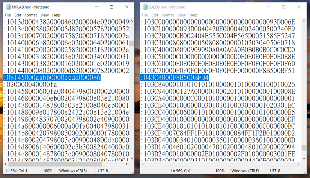

2. Question about NEX Address:
Why is there a mechanism for line breaks or data length changes here?

good starting point is for example - Intel HEX - Wikipedia
The diference is probably caused by different architecture - Microchip uses for their advanced MCUs MIPS instruction set, S32DS is for ARM or Power PC architecture. On MPLAB image you can see, that each second line is Extended Linear Address. Image from S32DS contains in each line only data.
In my opinion - if you like to work with S32DS and ARM - better format for application image for bootloader is motorola s-record - SREC (file format) - Wikipedia - but it  my personal preference.

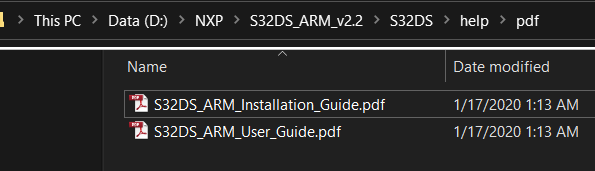

5,882 Views
johns_chuang
I didn't see the file you mentioned, is it because the version is relative?
V2.2 or V2018.R1?
Thank you for your help.
Carter
5,882 Views

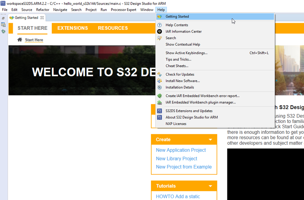

jiri_kral
in latest S32DS for ARM v2.2 is help integrated into IDE  - including video tutorials. You can find it in Help in menu bar:
Hope it helps.
Jiri

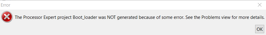

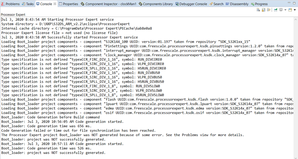

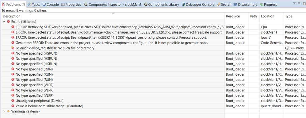

johns_chuang
Hi Jiri
I use S32DS.ARM2.2 to directly open the Boot_loader file in - Bootloader_s32K how it works for S32K144
Some problems have occurred, is it because of the S32DS version problem?
Carter
5,882 Views
jiri_kral
Hi Carter,
this is old project based on SDK which is not supported by new S32DS. You can create new empty SDK based project, add and configure very same Processor Expert components and add source code from old project into  new project.
5,882 Views

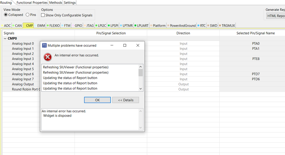

johns_chuang
Hi Jiri
I changed the configuration of the new version according to the old version of Processor Expert configuration,
But there was a problem when I set PIN_MUX,
Do you know why?
