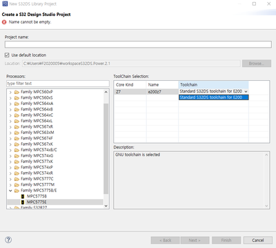

Hello.
I need to use S32DS For Power Architecture IDE and M(S)PC 5775E MCU
And I need to make Library File (.a file) for it with GHS Compiler.
So i have installed and imported the GHS Compiler to S32DS For Power Architecture.
But I can't make Library File.
I can't see the GHS Toolchain in the selection bar.
when i create application project, i can see it.
Can you please give me a little hand?

Hello @kmh48301,
First, use the wizard to create an application project, selecting GHS as the toolchain, then follow the steps in the attached document.
