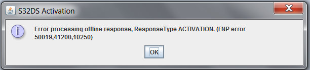

Is there a problem with the Offline activation of S32DS? I have created the request.xml using the activation code provided by Software & Support : Licensing. When using the activation.xml file returned by Software & Support I get an Invalid Offline Response. The installer then roll back the installation.

I have tried the online activation from home and the installation fails. I get the following dialog.
The error log shows the same failure as with the offline activation.
Install Uninstaller: S32 Design Studio for ARM v1.2(Install All Uninstaller Components)
Status: ERROR
Additional Notes: ERROR - Error writing LaunchAnywhere components (Access Denied)
Is there anything else you can suggest?

this error "Additional Notes: ERROR - Error writing LaunchAnywhere components (Access Denied)" could be caused by Java system path.
Look at the following threads, maybe it could help you a little bit.

Be sure to have Admin privileges during installation. On some systems the folders seem to be not writable to store license activation keys and temp files.  Recently at my customer, he had to not only run the installation with Admin privileges, but had to actually login as the Administrator.
On my own NXP laptop, I have to run as Admin in order for Processor Expert to generate code.
