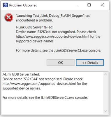

Hello team,
I've created a simple S32K344 example code with J-Link debugger in the S32DS 3.4, and the error below occurred when I built it and tried to download it. Could you please what's wrong?
Here are the error message in the console window.
Strict limitation error. Please check for correct device name and settings.SEGGER J-Link GDB Server V6.42a Command Line Version
JLinkARM.dll V6.42a (DLL compiled Feb 1 2019 18:00:08)

Failed to set device (S32K344). Unknown device selected?ERROR : Failed to set device.
GDBServer will be closed...
Shutting down...

jiri_kral
Hi James,
the j-link drivers/gdb server v6.42 is quite old. Please install latest version ( v7.80). You can download installer here - https://www.segger.com/downloads/jlink
During installation will install wizard ask if you like to update also S32DS with latest segger drivers.
Jiri
5,099 Views
james-lee
Hello Jiri,
Thank you so much for your answer. It's working now.
