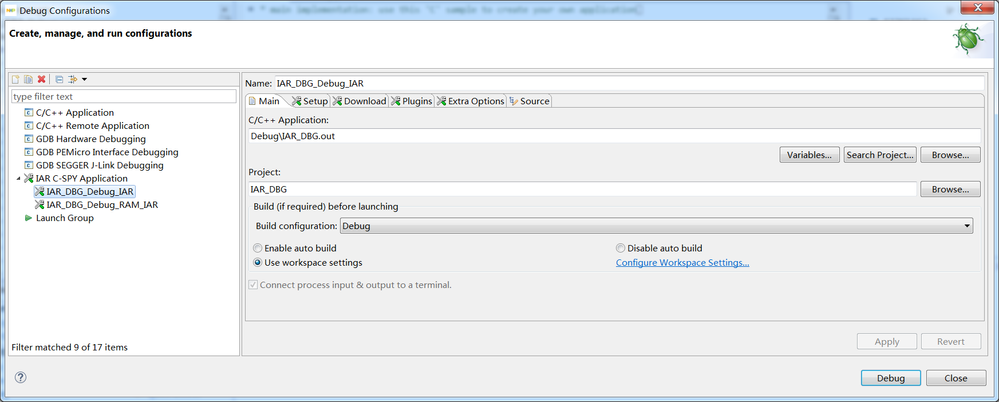

Hello Steve,
I'd recommend you to install IAR plugin into S32 Design Studio. This way you can build and debug your project using IAR tools from S32 Design Studio Eclipse IDE.
See attached screenshots
Hope it helps.

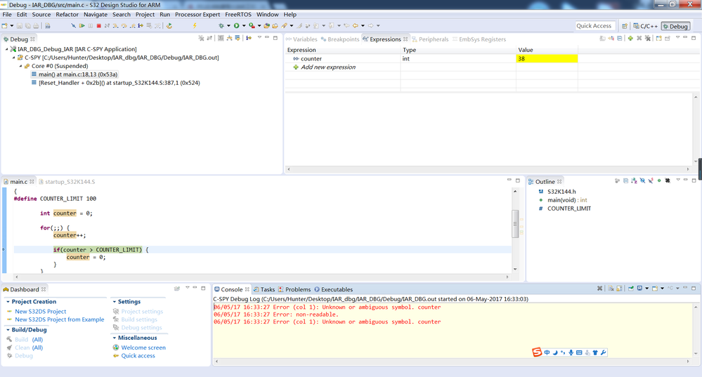

Hi Stan,
I have installed IAR plugin into S32 Design Studio, I can't build and debug your project using IAR tools from S32 Design Studio Eclipse IDE.When I debug my project ,the debug window remains in S32DS.
And I want to debug my project in IAR,but this way has no effect.
Additions, I can't watch variables and expressions when the target is running In S32DS Debug window,
Can you give me some suggestions about this problem.
And I don't know how to create a  project of S32K144 in IAR, Can you provide me some S32K144 demos In IAR environment.
