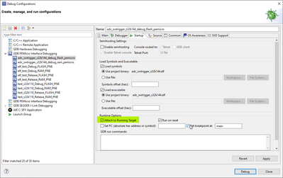

使用S32的Debug功能可以在开发板上运行程序,功能正常,但是断开JTAG连接后,重新供电,程序不会运行。使用J-Flash下载程序,也无法运行。请问如何解决?

Florijan
Hi Alien!
Sorry for the late response. I had the same issue and I found out that the problem is the NMI interrupt which is sometimes triggered after reset in standalone mode but not in debug mode with probe connected. The walkaround I've used is to simply add disable NMI interrupt instruction in NMI interrupt rutine itself (in my case it is located in a file "events.c":
void Cpu_OnNMI(void)
SIM_SOPT0=SIM_SOPT0 & ~SIM_SOPT0_NMIE_MASK; // here you disable NMI interrupt

are you able attach into running program and see what's going on? Anyway, what's your MCU?

jiri_kral
what about attach to running target? At last you can see on which address is program stuck - some unhandled interrupt or exception?
