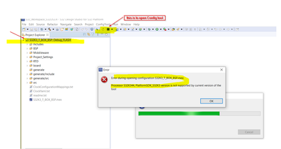

As I can see here: https://www.nxp.com/design/designs/s32k3-automotive-telematics-box-t-box-reference-design-board:S32K...
There a BSP package, in my opinion, this is can be used as a base for SW building for the T box ready for the components on the board ( Trcvs...etc)
But the problem is, once I import this BSP as a project, I got this error message
 Hope you get my point.
Regards Ahmed

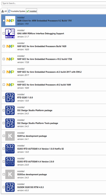

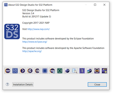

Ahmed_Saber
Also,
this is the installed packages
And this the DS32 tool version I have installed

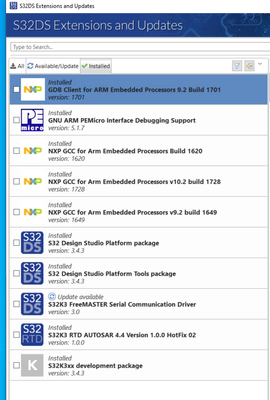

lukaszadrapa
I tested it on my side. I have almost the same SW configuration here (only a few more packages which should not be important here), I downloaded and imported S32K3_T_BOX_BSP.zip and I can open the configuration tool and I can compile the project.
Is that really original project from S32K3_T_BOX_BSP.zip? Have you made any changes there?
https://www.nxp.com/webapp/Download?colCode=S32K3-T-BOX-BSP
My SW:

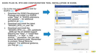

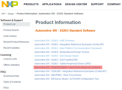

lukaszadrapa
Hi @Ahmed_Saber
let me check this with owners of the T-Box. I can see two getting started documents and SW enablement guide and all of them says something different. I'm sure that specific RTD version needs to be used.
Generally, the RTD can be downloaded from S32K3 Standard Software Package. The link can be found here in the mentioned document:
this will redirect you here (RTD link highlighted)
I will let you know later which version should be used exactly.
