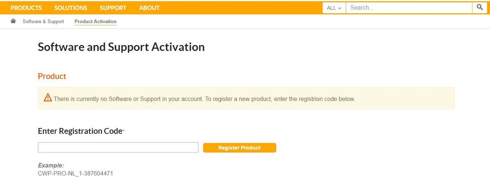

I'm trying to activate "S32 design studio" on my workstation with offline activation method. Although I've found the Software Licensing and Support tab, I can not find how to manage offline activation job from here. The screen I had is this:
How can i use the "request.xml" that i've given by the installer from here?
Thanks in advance

stanish
hello Ali,
Please have a look here: Offline activation on S32
If you get "Invalid offline response, ResponseType" please check the fix here:  https://community.nxp.com/docs/DOC-334344
hope it helps.

alikozan
Hello again
Solved it. It was because of downloading software while not logged in, so the product was not registered. I started a download session after logging in, and the product has been registered. Just after that, I've been able to activate the product by the way you offered. Anyway, thanks :smileyhappy:
