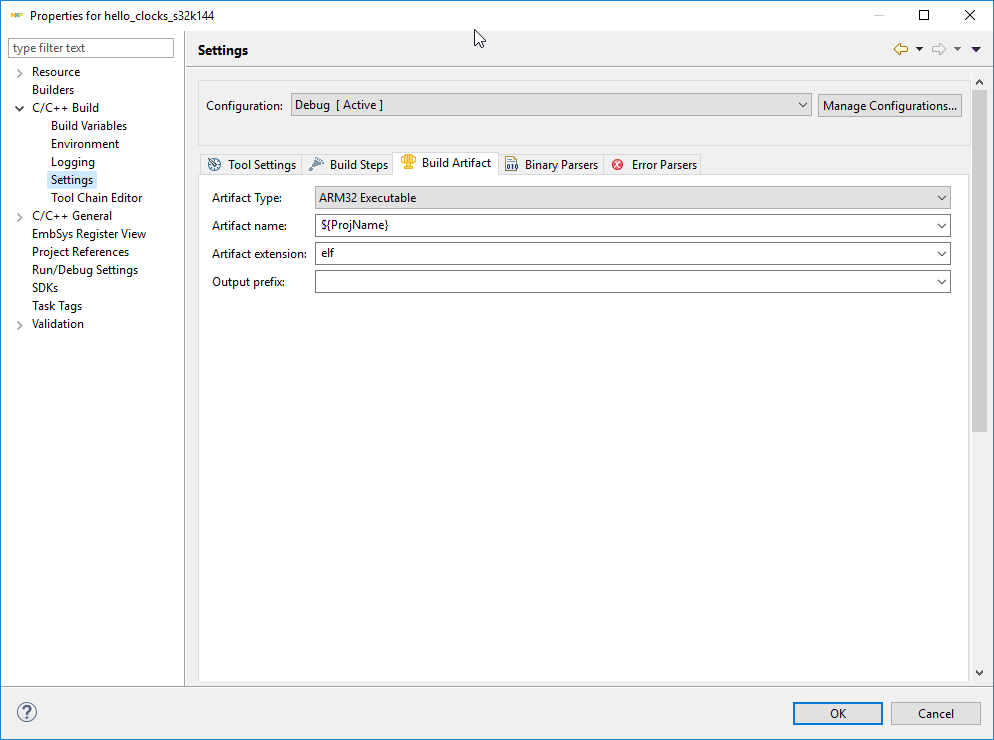

jiri_kral
If you remove creating .srec file, are you able get .elf file? From the output it looks like that the .elf is missing as a .srec source. Any other error messages in console?
Do you have default output settings like on this screenshot (in project properties):
Jiri
