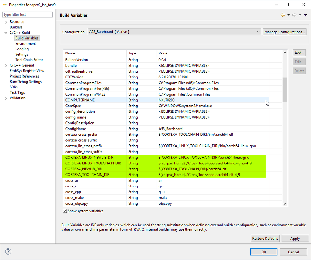

I ran crash on sbc32v234 while compiling the demo project via S32DS.
I think it should be caused by compiler inconsistency, my hardware bsp17.0 compiler is gcc 6.3.1
The default compiler for S32DS is gcc 4.9.
How to change the default compiler?
Is there a tutorial?

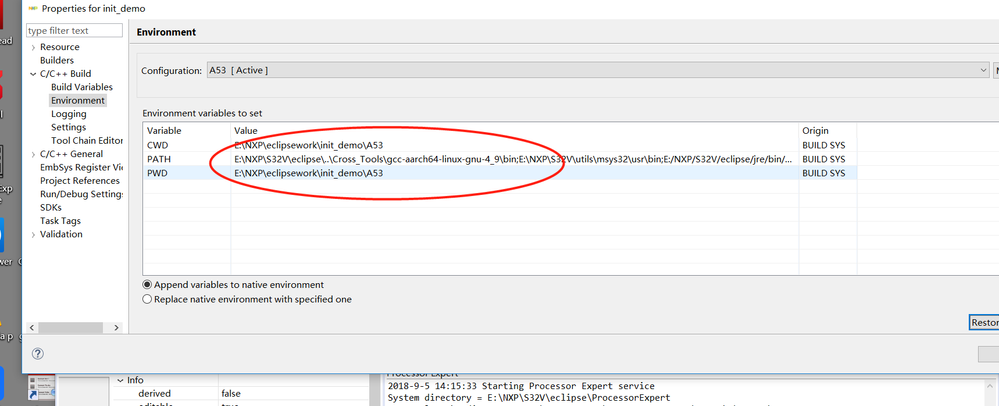

I changed this and it didn't work. It still crashes when running.
2,507 Views
jiri_kral
S32DS for Vision is supporting gcc 4.9. You can try to add gcc 6.3 by changing some env variables in project properties:
But I'm not sure if it will work. Testing is up to you. gcc 6.3 will be supported with next S32DS Vision release.
