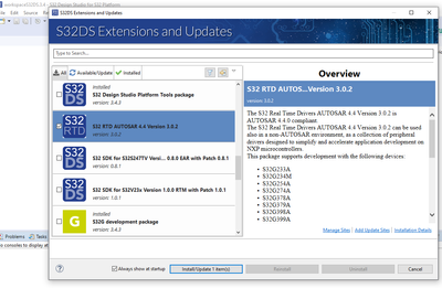

noticed the S32 DS 3.4 update 3 provided S32 RTD Autosar 4.4 version 3.0.2:

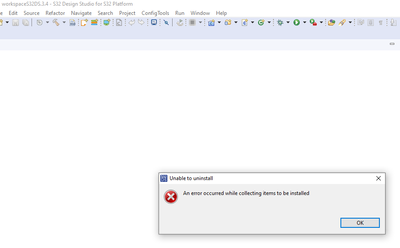

when I clicked install, it always break in the middle, showing same error as below:
any idea about this error?

We have the solution. It appears it is an issue with the Eclipse cache relative to this RTD package. Please delete the following directories and try again. It should resolve this issue for you. It worked in my case.
<Install Dir>\S32DS.3.4\eclipse\p2\org.eclipse.equinox.p2.core\cache\
<Install Dir>\S32DS.3.4\eclipse\p2\org.eclipse.equinox.p2.repository\cache\
Please try it and let us know the result.

mikedoidge
Hi Albert,
I was able to reproduce the issue on my end. It appears to be a problem with the update server. I will report this to the responsible team. They should fix it by tomorrow.

asap
thank you mike, but so far the issue remains.

mikedoidge
Hello Albert,
Could you check your workspace directory for a file named '.log'. It should be located like follows: "C:\Users\Public\workspaceS32DS.3.4\.metadata\.log". In place of public, it may be your user id.
If you could share this file, there should be some entries that provide more details on the issue.
