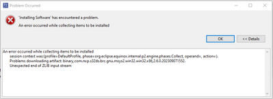

I am not able to install S32 Design Studio Platform Tools package on my S32 DS 3.5 version.
I am getting the below error

I reinstalled DS3.4 and I was able to download R41 package. Thank you.

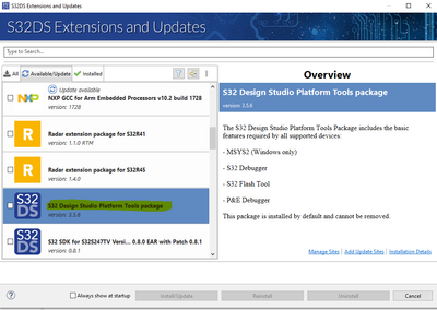

jiri_kral
Typically the Platform Tools Package should be updated from already installed packages. It is basic part of S32DS. Other packages in Installed tab are updated to latest version?
2,348 Views
Luffy_D
I am trying to install R41 package.
This package includes the tools package and I get the same error while installing via this package.
