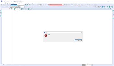

I've somehow managed to mess up S32 Design Studio for S32 Platform and am no longer able to select/view my project.  Here's how I got to where I'm at:
  1. Opened/imported the S32K142_CAN_bootloader project from the Unified Bootloader Framework installation package
  2. Made a few minor code edits, have it building successfully
  3. Opened the ConfigTools => Pins menus selection to try to view pin mapping/configuration
  4. Found that there was nothing in this view...apparently this GUI tool hadn't been used to generate the pin configuration code (although the C files for pin configuration were in the "generated code" folder structure - so what was used to generate them?).  When I go to "Config Tools Overview" I get a popup telling me that there is no configuration created yet.
  5. After opening the Pins view, I get a red error in the toolbar telling me "MCU is not selected"
  6. When I try to open my project using the toolbar I get an error popup that simply says "null" (see below)
  7. The project still appears to build but for the life of me I can't figure out how to get back to the "original" GUI layout with the project structure window, etc.  I appear to be stuck in the ConfigTools screens and can't get out of them.
I've got to be missing something really simple here but can't figure it out.  Any advice is appreciated.

mikedoidge
Hi Andy,
If your main goal is just to get the screens back the way they were, then use the menu command 'Reset Perspective':
As for the migration of the project, I'm afraid @jiri_kral is correct. It was created for ProcessorExpert so there may be some work involved to reproduce the same settings within S32 Configuration Tools.
Hope it helps,

jiri_kral
The project is for Older S32 Design Studio for ARM v2018.R1 and is not compatible with S32DS v 3.4. Please download older S32DS.
