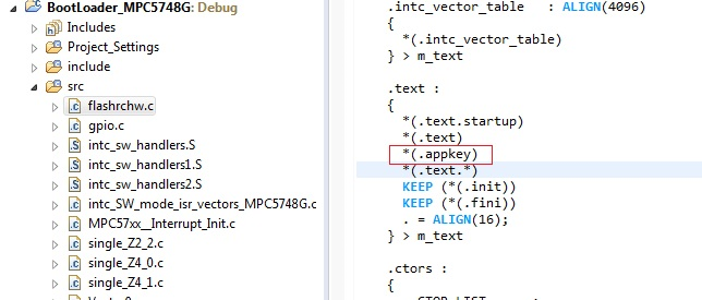

  • Modify the linker file as shown below by adding a new line *(.appKey) into the .text segment:
Figure 6.2.2

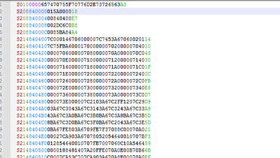

  • The example output .srec file generated by the compiler integrated in S32 Design Studio:
  • The first part of the file:
Figure 6.2.3

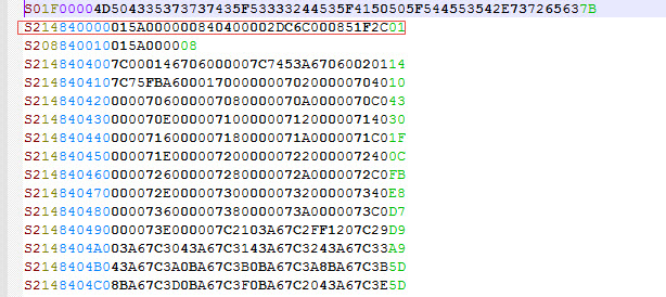

  • The last part of the file:
Figure 6.2.4
