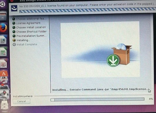

I'm trying to install S32_Power_Linux_v1.1.bin on linux(Ubuntu12.04),but it does not ask me to inser the activation ID  and unroll the installation.

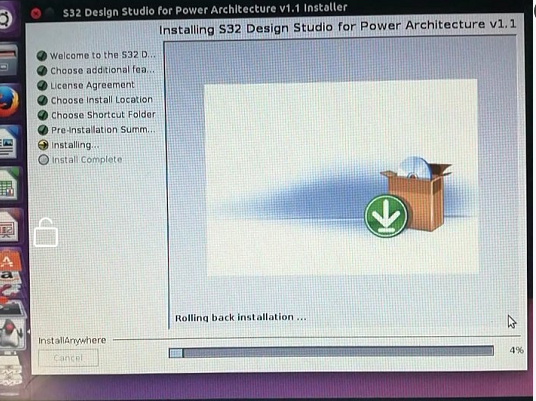

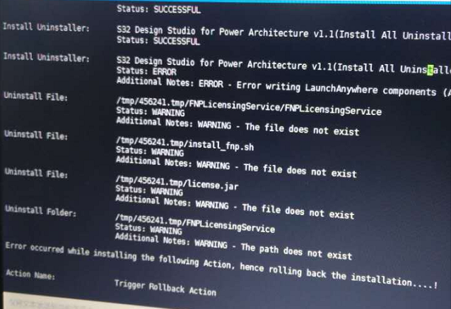

jiri_kral
I tried install it on Ubuntu 12.04 and 14.04 - and ended with the very same messages in the log - even with root privileges. I'm able install it on Debian 8 and Ubuntu 16.04. I'm going to create ticket for S32DS team.
