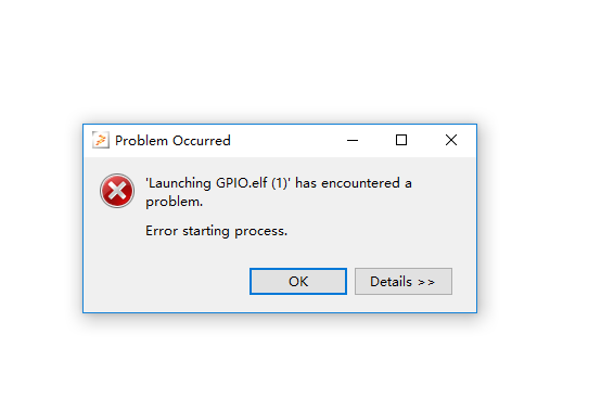

johnssheng
Launching  GPIO.elf has encoutered a problem.Error starting process.when I press  "Run"button.I am using MPC5604B.
any idear  ,thanks.
2,601 Views
martin_kovar
unfortunately, RUN button is not implemented correct. You have to use Debug button instead of RUN button. Debug button works correct.

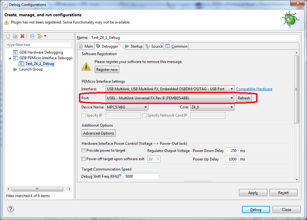

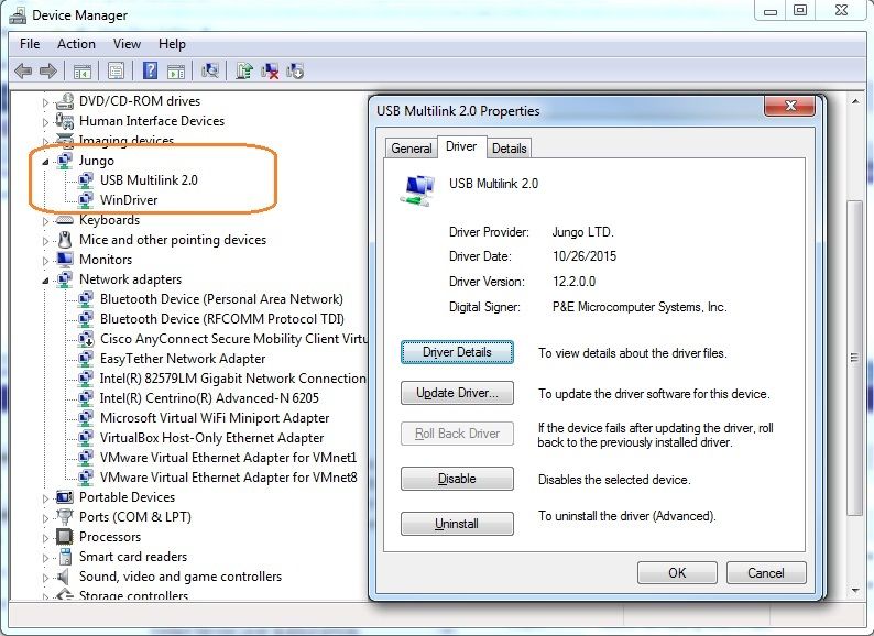

stanish
Vlad,
Can you possibly check if you can detect your Pemicro USB Multilink cable in the debug configurations dialog:
Also please check if the Pemicro driver is correctly recognized:
If this is ok can you check:
* P&E ribbon cable orientation is correct.
* Board is powered up (both LEDs - blue, yellow on Pemicro box should light)
* MCU may not sit correctly in ZIF socket - you can try to push and release the socket several times, is MCU orientation ok in the socket?
* Daughter card jumpers are correctly set up to 3.3V
Do you have any other MPC56xx or MPC57xx board you could test?
Hope it helps.
Stanislav
