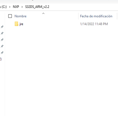

Hello, a License missing error appear when lauching S32 Design Studio for ARM . I'm tried to re-install S32 Design studio for ARM but a pop up window appear with the message "No S32DS-IDE-ARM_2.2 license found on your computer" and stop the installation process. Could you help me?

I have follow all steps from this chat "HOWTO: Activate S32 Design Studio" and nothing, the same problem.
About this workaround: "S32 Design Studio for Arm stuck at Licenses Verification", the program never install and ARM product instllation directory only has directory showed on attached image. Any other suggestions.

I tried to reproduce your issue. I am able to get to the prompt for the activation code. If I press cancel, the installer rolls back the installation. I am able to locate a new installation log file in the folder: C:\NXP\S32DS_ARM_v2.2\_S32 Design Studio for ARM Version 2.2_installation\Logs. I see in your reply that you do not have this folder, but instead a JRE folder. This seems strange. You would not have this folder yet if the rollback occurred before the activation code prompt. Have you previously successfully installed S32 Design Studio for ARM?

The installation log file don´t appear while installer window is active. However, i closed it from task administrator and rollback the installation process. Attach the log file obtained.
