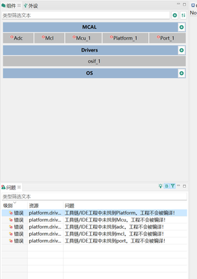

zp001
Hi Mike,
I also found some abnormal things that there were always some modules could't be loaded successfully. I hadto add them one by one.
Even through the project can be build normally after that, It's weired a little bit,but I don't know why.
scrreenshot as below:

mikedoidge
This is not normal behavior. There is no setting to cause this. The comparison window should only appear when a comparison is performed, not from Update Code command.
Could you please share the file '{workspace_path}\.metadata\.log'? It should contain some clues regarding what is happening.

zp001
Hi Mike,
There is another way to fix that by deleting .metadata dirctory.
Thanks!
