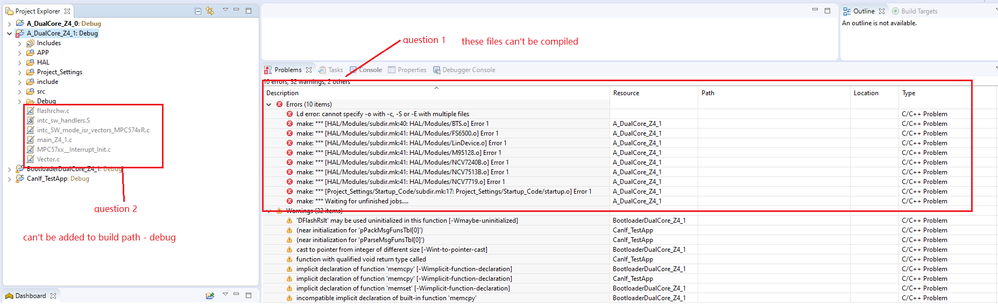

Dear NXP experts:
Could you do me a favor to support me on this S32 Design Studio issue?
the MCU is MPC5746R, S32 Design Studio V2.1, the  CORE0 project  can be built successfully.
But forCORE1 project , there're following Errors, and no hint to fix:
1) several files can't be built
2) files like flashrchw.c, main_Z4_1.c can't be added into build path-debug, there is a '/'
thanks and BR
YiChuan
1,742 Views
ZhouYiChuan
PS:
there is no hint for the errors in files like BTS.c , FS6500.c etc, only a simple error description in the snapshot  is provided by S32.

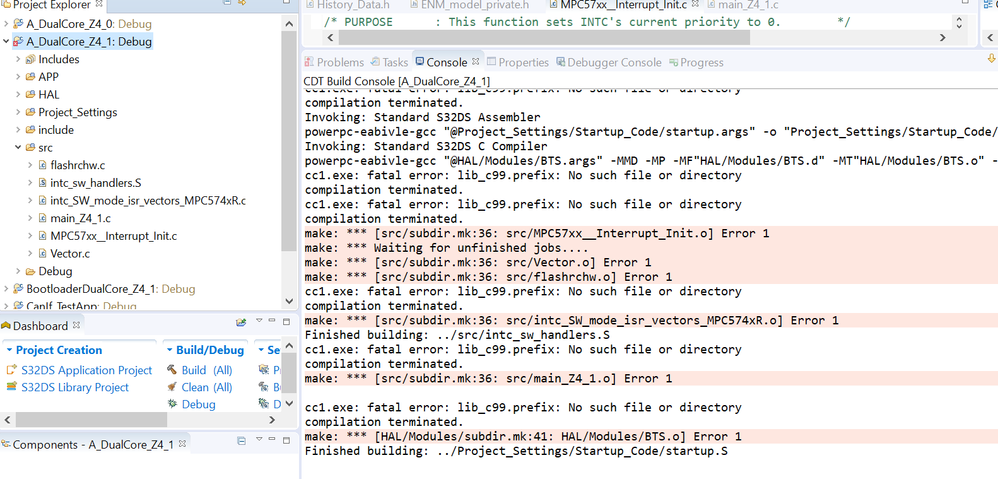

can you please share output from build console?
Jiri

ZhouYiChuan
Hi, Jiri:
There is some issue in the output built from newly created MPC5746R project .
So , could you please support me on the building issue of older 5746R project.
the console is below:
thanks and BR
YiChuan
1,717 Views
ZhouYiChuan
Hello Jiri:
After I created new MPC 5746R projects and merged the codes into new projects, the issue was resolved.
Maybe the reason is the old projects was created with different S32 DS version.
Anyway, thanks a lot !!
