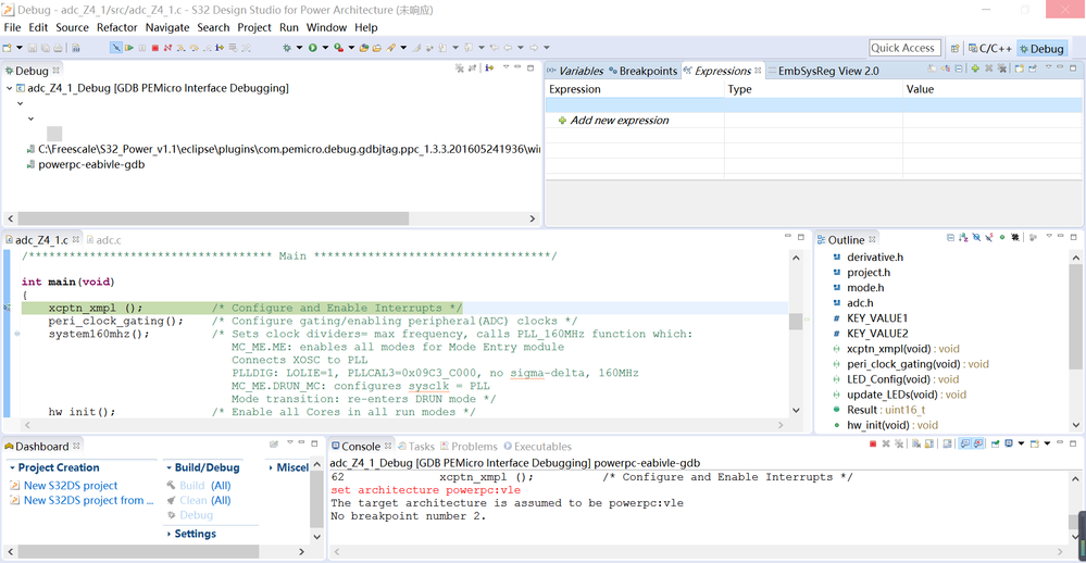

Hi every body,
    I can't see any variable in the variables window. I want to check the value of some variables, but when I tried  to add them to the expression window, they didn't show , and the software often encounter a problem of no response.
     What is the correct way to check the value of variables? Any tips would be highly appreciated.
Best Regards
Qiao

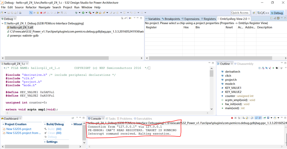

Sometime this problem occurs. You can see in debugger view, it is not displayed fully. You should terminate and debug again and recheck. Hope to help you.

    I still can't see any variable or register...Have you ever encountered this situation?
2,741 Views
stanish
Unfortunately S32DS cannot display/update neither a variable nor peripheral register while the target is running.
You should suspend the execution first and then check the "Expressions/EmbSysReg" Views.
