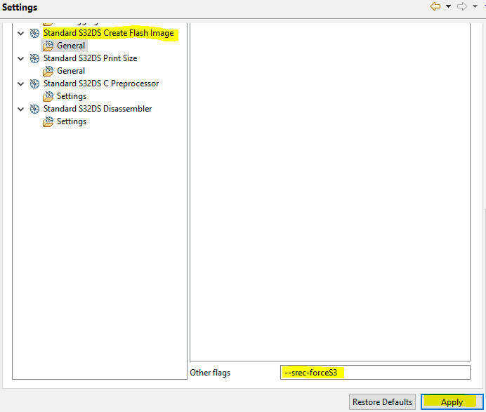

Using S32DS for MPC5777C. Default /example project. In Properties>ToolSettings>CrossSettings I have Create flash image checked. Under create flash image>General I have Motorola S-rec selected. When I build I get the s-rec. But it is always S2. How can I get S3?

Fantastic, that does it. Thank you very much.

I would be happy to try that. But I do not know where I would put that line / command; hardware guy writing test code.

alexanderfedoto

Fantastic. Thank you.

Have you tried "--srec-forceS3" ?

Thanks, I’d be happy to try, but I don’t know where to put that line/command; hardware guy writing test code.
