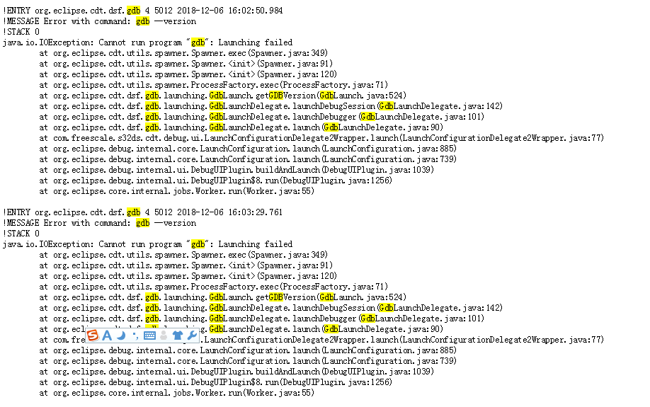

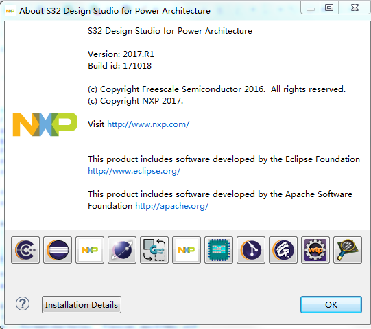

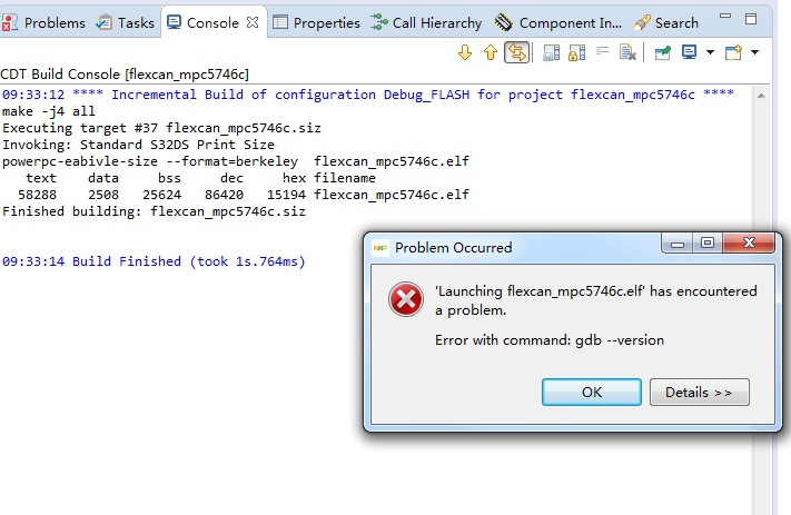

Hello Guys,
      could you please help to check this issue for the S32 Design Studio for Power Architecture Version: 2017.R1 ,
i already update to the lasted S32DS.
Tags (3)
9 Replies
4,829 Views
jiri_kral
can you please attach output from your debug console?

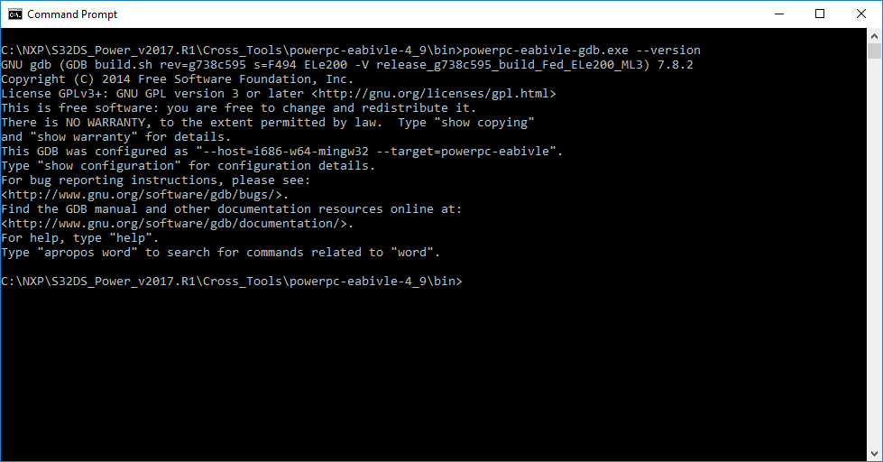

Also make sure that the powerpc-eabivle-gdb.exe file is present in
c:\NXP\S32DS_Power_v2017.R1\Cross_Tools\powerpc-eabivle-4_9\bin\
folder and you can start it from windows command line:
Jiri

alex_yu1

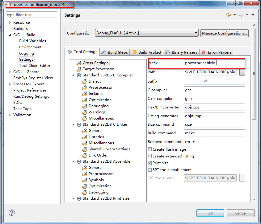

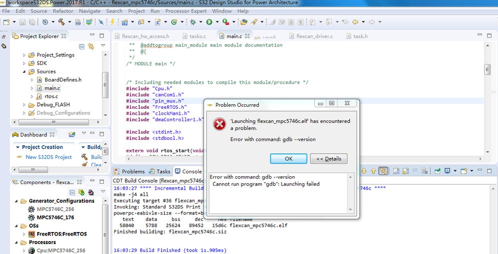

hello,Jiri,
      check the  powerpc-eabivle-gdb.exe is under the right fold as following。
the debug console as following:

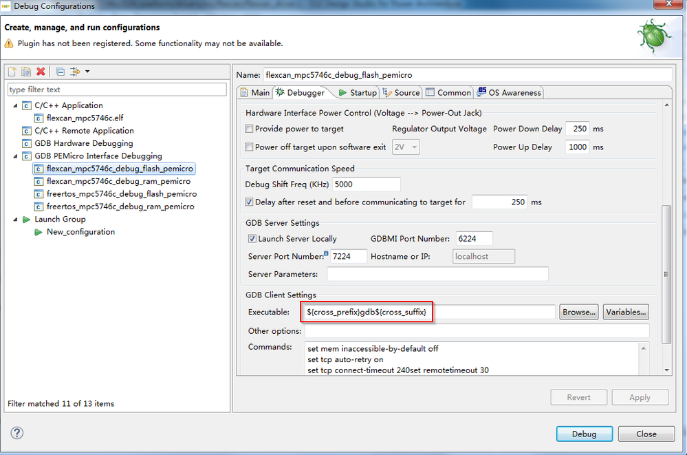

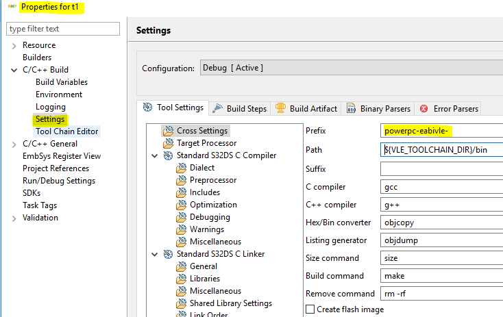

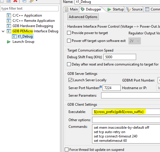

alexanderfedoto
Seems like you are trying to use wrong launch configuration.
Please make sure you have the following:
And correct prefix here

alex_yu1
hello
      There are configuration for the debug interface

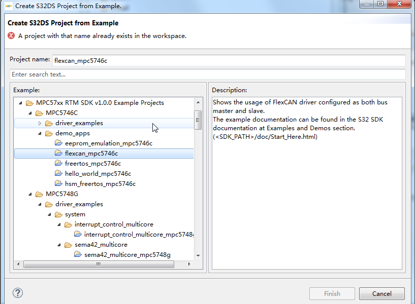

alex_yu1
hello
      it seems can not export the project setting,since it with processorexpert。
is it possible that the firewall will block the S32DS call the gbd.exe?  this project is the sample of S32DS.

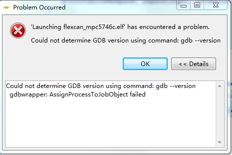

alex_yu1
hello
     i uninstall the symantec software , reinstall the S32DS, and there are another issue report when lauching.

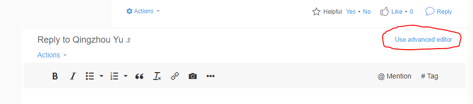

mikedoidge
Hello alex_yu,
To share your project, please create a ZIP or similar archive of the project folder in your workspace. Then use the 'Use advanced editor' link in the comment window here to add the attachment.
