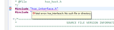

hello:
Can't it be configured this way? Why is it still wrong when quoted like this?

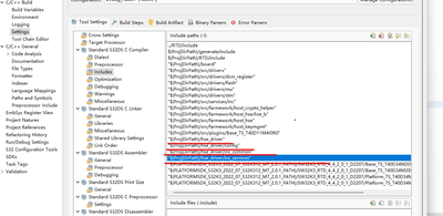

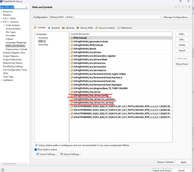

Hi @youxi
Could you try Index -> Rebuild or Index -> Re-resolve Unresolved Includes? You can find these options in the Project tab or right-click on the project.
