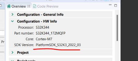

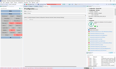

I am using S32DS 3.4 and installed SW32K3_RTD_4.4_1.0.0_HF02_DS_updatesite_D2112, then imported (File->Import->Existing projects into workspace)  the S32K3_T_BOX_BSP.zip project.
While the project appears to import fine, the peripheral configurator shows many errors.
Is this common? Is there something I should be doing differently?

the SDK you're using is RTD 2.0.0,not RTD 1.0.0
This is a known tool bug, please try the following.
"If you installed both RTD RTM 1.0.0 and RTM 2.0.0. to avoid project RTD version auto conversion which would break up the old version projects, try to remove the "compatibility.xml" located at "
C:\NXP\S32DS.3.4\eclipse\mcu_data\configuration
