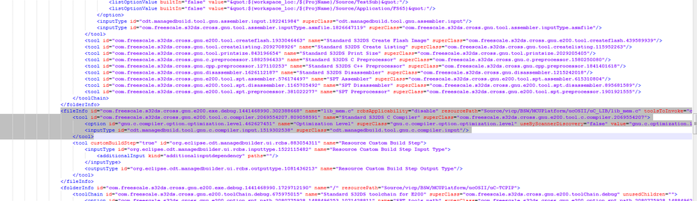

I turn on compiler optimizations in my project, but got some errors while trying to rebuild the code:
Program "gcc" not found in PATH [Discovery Options] page in project properties C/C++ Problem
What can I do to fix this error?
Thank you.

I had the same problem and solved it with this method:
Add your gcc path to the end of PATH,
for me is ";C:\NXP\S32DS_Power_v2017.R1\Cross_Tools\powerpc-eabivle-4_9\bin"
Done.

please check if you have set the prefix for gcc:
and VLE_TOOLCHAIN_DIR/bin points points to folder with cross tools binaries. Also check if the binaries are physically present on the hard drive.

alexpan0523
Hi, Jiri
I have checked the settings you mentioned above,but they don't work.
I find If I delete the optimization info in .cproject file and then built,the  Program "gcc" not found in PATH  error message will be removed,but the optimization level of lib_mem.c will be changed from O3(what optimization level I want) to none automatically.pastedImage_1.png

jiri_kral
Hi Alex,
I tried reproduce the issue - but no success. Can you please share the .args file for your lib_mem project with Level 3 optimization enabled?
