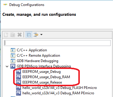

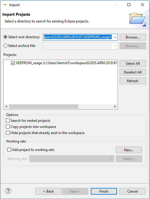

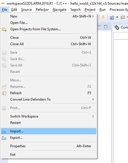

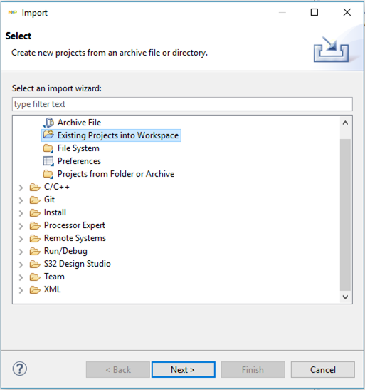

Hello all,
I have problems with import exist project into s32ds for arm 2018.R1
I imported exist project EEPROM_usage (I downloaded from a threat on this forum), but it doesn't include Debug_FLASH PEmicro/Debug_RAM PRmicro so I can't build it successfully. But I import normally "S32DS projects from example" without any problems like that.
Imported steps are followed below (imagine), please teach me why :Untitled_01.pngUntitled_02.pngUntitled_03.pngUntitled_04.pngUntitled_05.png

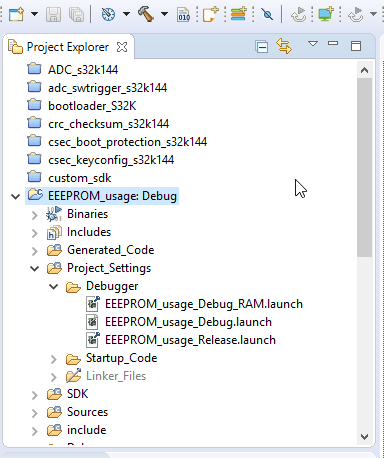

jiri_kral
it should work correctly. I just tried it and no issue. Please check if Project_Settings/Debugger folder contains all .launch versions.
If not - feel free to use attached ones. Anyway - It looks that you are importing project which is already in workspace folder, correct? Try to import it from folder outside of your workspace.

bidinhol
Great, your suggestion resolved my problem !
I imported exist project from folder outside of my workspace,
and there was no more issues like before.
I approciate your helping, thanks very much.
