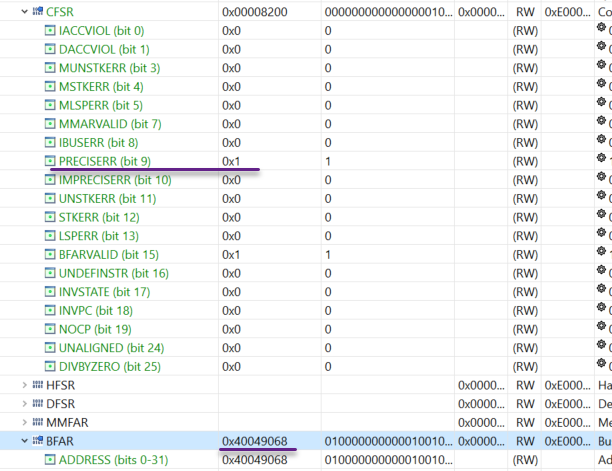

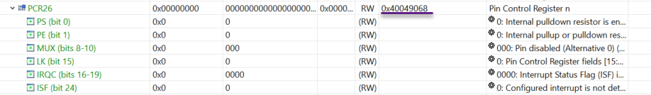

I have just run you project and could reproduce the fault on S32K148_144 EVB.
As you can see below, it is a precise bus fault at address 0x40049068.

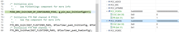

When the PINS driver is initialized, the PORTA PCC clock is gated off.
The CLOCK_SYS_UpdateConfiguration(0U, CLOCK_MANAGER_POLICY_AGREEMENT); function returns STATUS_TIMEOUT because the SOSC module clock cannot be validated.

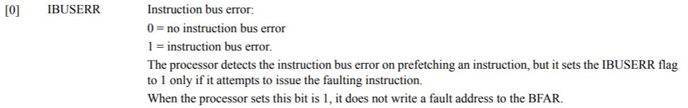

But there is still an error present. If I want to step throug the main program, the program runs into default ISR (file startup_S32K148.s line 377) within CLOCK_SYS_UpdateConfiguration(). If I check then the registers, I can see the following:
So there seems to be still a problem with the SOSC module?

Hi Mario,
An instruction bus error, but hard to say what is the cause.
