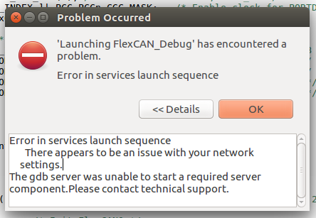

When I try enter debugging mode in "S32 Design Studio 2018" (Linux 64, Ubuntu 16.04.3) an error popup tells me that:
Error in services launch sequence
There appears to be an issue with your network settings.
The gdb server was unable to start a required server component.Please contact technical support.
Anyone know the case or can help me?

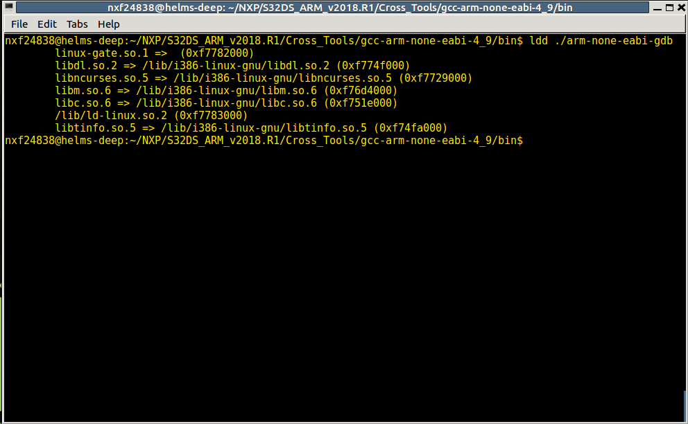

Hi Roi,
there is probably missing ncurses5 32 bit library on your machine. Please check with ldd command if all libraries for gdb are present:
ldd [YOUR_S32DS_INSTALL_PATH]/Cross_Tools/gcc-arm-none-eabi-4_9/bin/arm-none-eabi-gdb
Jiri

I have all this libraries:
ldd ~/.NXP/S32DS_ARM_v2018.R1/Cross_Tools/gcc-arm-none-eabi-4_9/bin/arm-none-eabi-gdb
    linux-gate.so.1 =>  (0xf7fcb000)
    libdl.so.2 => /lib/i386-linux-gnu/libdl.so.2 (0xf7f9d000)
    libncurses.so.5 => /lib/i386-linux-gnu/libncurses.so.5 (0xf7f77000)
    libm.so.6 => /lib/i386-linux-gnu/libm.so.6 (0xf7f22000)
    libc.so.6 => /lib/i386-linux-gnu/libc.so.6 (0xf7d6c000)
    /lib/ld-linux.so.2 (0xf7fcd000)
    libtinfo.so.5 => /lib/i386-linux-gnu/libtinfo.so.5 (0xf7d48000)
But problem still there
