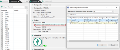

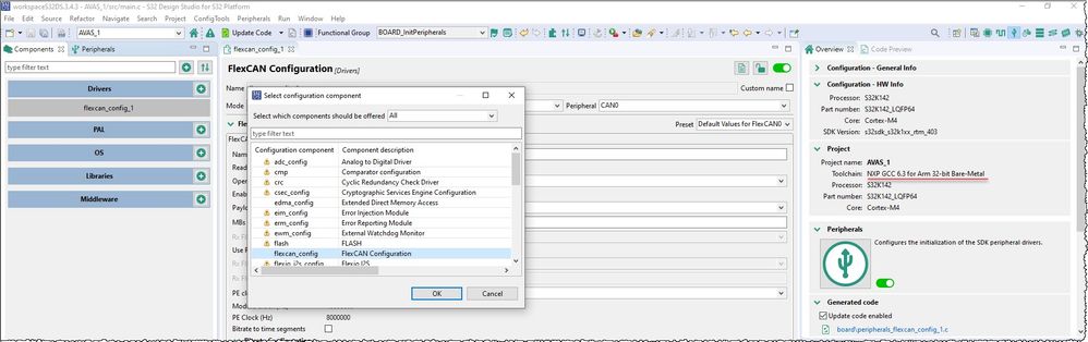

When I try to configure any peripheral from Peripheral Option , It is showing that Peripheral not present in toolchain project. If I select All available component then it is giving below warning.
Below are some details of project.

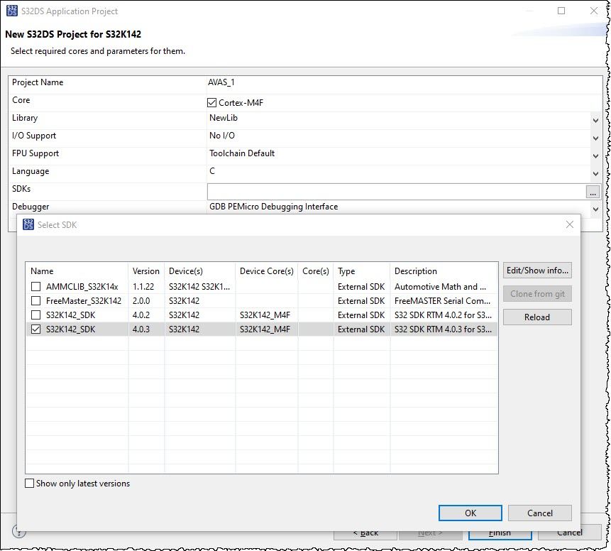

Do not use S32DS v3.5, please use S32DS v3.4+S32K1 SDK RTM4.0.3.

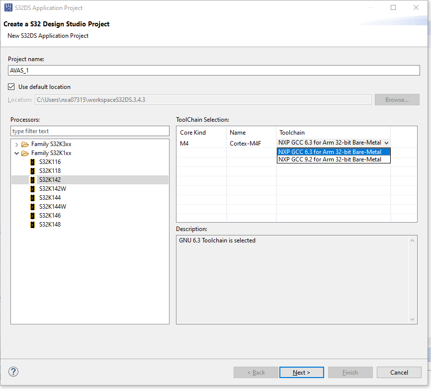

Please select NXP GCC 6.3 for Arm 32-bit Bare-Metal Toolchain when create S32DS Application Project.
Create new S32DS Application Project.pngCreate new S32DS Application Project.pngSelect SDK.jpgSelect SDK.jpg
After you double-click the component you want to add, this warning will disappear.

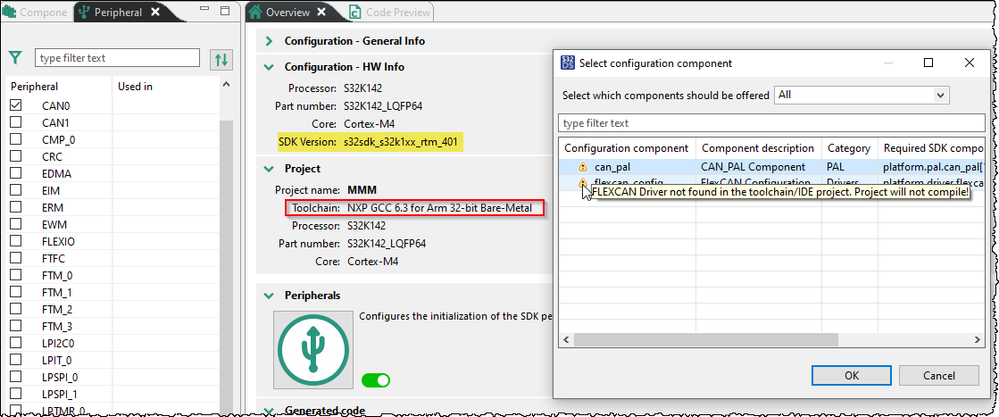

Hello Robin,
I tried same as your given steps but still having same warning.
please provide solution ASAP.

Have you tried S32DS v3.4+S32K1 SDK RTM4.0.3? It looks like your project is still using the old S32K1 SDK RTM4.0.1
