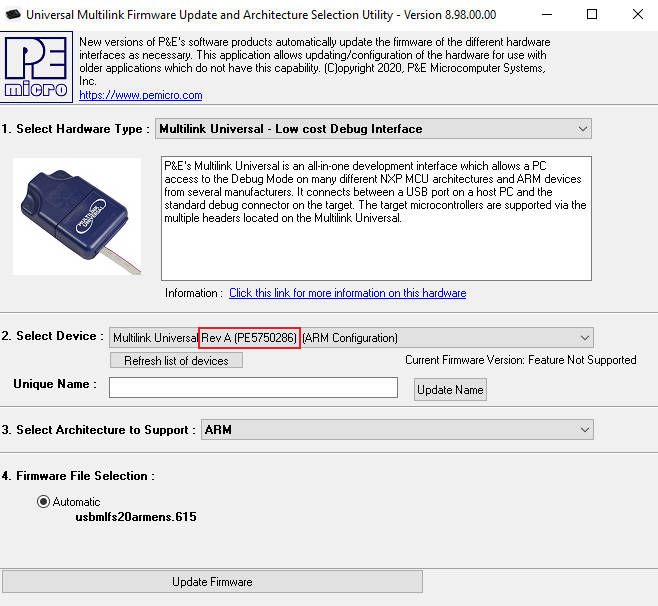

When I use PEMicro to link to my S3258 board, I got bellow issue "This hardware interface is an older model and does not support this device"
* does this mean my PEMicro version is too low?
* my PEMircro version is shown as bellow, does the 'Rev A' not support S32K358 and I should purchase a new version, and which version ?

The PE multilink debugger you are using does not support S32K258 series.
You will require to use PEMicro Multilink FX.
Please check PE Micro website for more information for supported version, and hardware series.
https://www.pemicro.com/products/product_viewDetails.cfm?product_id=15320180&productTab=5046
https://www.pemicro.com/arm/device_support/NXP_Automotive/index.cfm

I purchased Multilink Rev.E, which solved this problem
