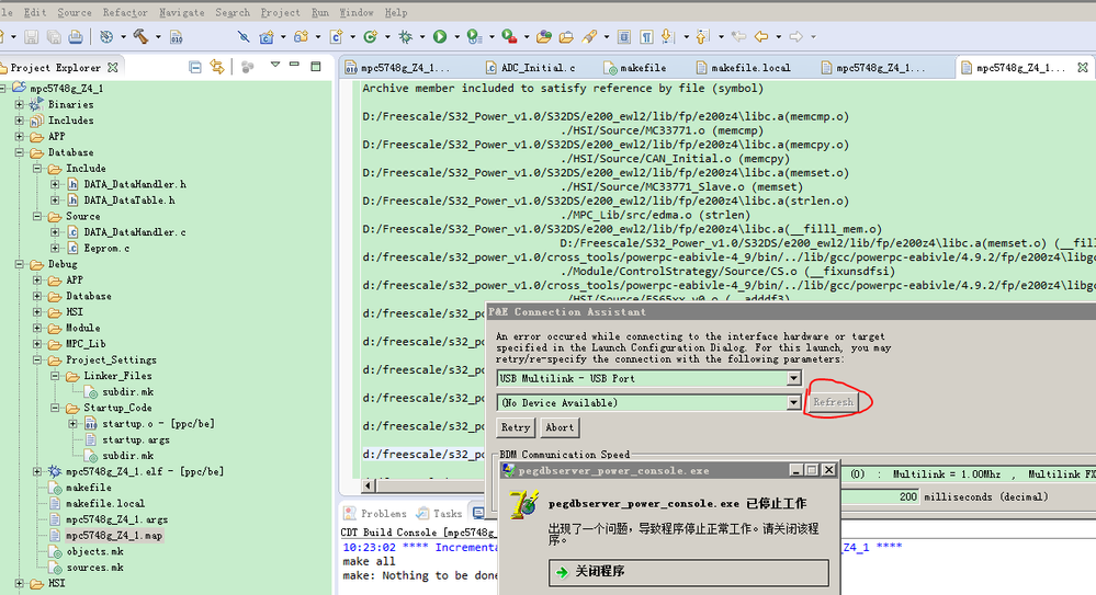

   My computer is win7-64bit. When I install s32 V1.0 for power pc, the last step is PE multilink driver installing, and it came up an error pop-up. The msg is shown as below.

Luckily, I still can install the PE multilink driver via computer device manager.
But when I tried to debug my project with S32, it still can't recognize Multilink. Every time I click refresh, then pegdbserver_power_console.exe stops working.
Could anyone give me a hand about this issue?

yuehedeng
Martin, other computers can install s32 successfully. So I reinstall win7 operation system, and it works. Now I can use s32 and multilink successfully.
Thank you.

I strongly recommend you to use S32Design Studio for Power Architecture version 1.1. Many bugs are fixed in this version. Could you please try install this version and check, if there is the same problem with PE Micro drivers during the installation?
From your post it seems, there could be some driver conflict. Please try install new version of S32DS and if it does not help, download the drivers directly from PE Micro website and try to install it independently (I am sorry that I cannot provide you URL address, but PE Micro website is down right now).
If any of the points mentioned above will not help you, run gdb server manually. Executable file is placed in S32DS installation folder /Cross_Tolls/powerpc-eabivle-4_9/bin.
Manual start of gdb could provide us more information about issue (in case there will be problem).
Martin
