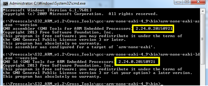

Assembler and Linker version:
Stan
2,948 Views
stanish
Hi Kate,
There is no compiler version visible in S32DS Installation details. It shows just version of an eclipse plug-in.
In order to get the version of gcc you should run "arm-none-eabi-gcc --version" from the command line:
Stan

Could you let me know how to check the version of assembler and linker also?
