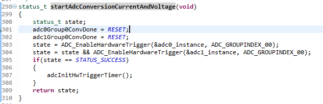

In a project I want to use the ADC_PAL component for group conversion.
For this I have have two ADC_PAL components with each a group with different adc channels.
Now I want to have these two groups triggered by a LPTMR component continuously. Both adc have the same settings, but adc1 is not running.
Is it not possible to use one LPTMR instance to trigger two ADC_PAL instances?
Here you can see the start of the continuous conversion.
Thanks for your help
regards
Mario

Hi Mario,
The problem is caused by this line in the application code:
status_t adcStartConversionCurrentAndVoltage(void)
state = ADC_EnableHardwareTrigger(&adc0_instance, ADC_GROUPINDEX_00);
state = state && ADC_EnableHardwareTrigger(&adc1_instance, ADC_GROUPINDEX_00);
The compiler optimizes out the second call to ADC_EnableHardwareTrigger(&adc1_instance, ADC_GROUPINDEX_00);
This most likely happens because the first call returns state == STATUS_SUCCESS, which is in fact 0x0000 => && operation with 0 will always be false, so no need to call ADC_EnableHardwareTrigger(&adc1_instance, ADC_GROUPINDEX_00);
Change the line to something like:
state0 = ADC_EnableHardwareTrigger(&adc0_instance, ADC_GROUPINDEX_00);
state1 = ADC_EnableHardwareTrigger(&adc1_instance, ADC_GROUPINDEX_00);
if( state0 == STATUS_SUCCESS && state1 == STATUS_SUCCESS)
and the scenario will work fine.

cosmindinu
Hi Mario,

EE_CW
Hi Cosmin
Thanks for your answer.
With your suggestion it works. Thanks a lot.
regards
Mario
